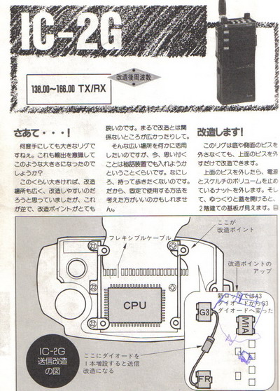

« ตอบ #4 เมื่อ: พฤษภาคม 02, 2007, 12:47:41 pm »
วิธี Reser เปิดปิดหน้าเครื่อง ส่วนรูปเป็น การเปิดแบนด์ ภายในเครื่อง
To RESET the CPU (and wipe out memory), hold the LIGHT button AND the FUNCTION button while CPU is on, then turn it off,wait a second, and turn it back on. Continue holding the buttons while all the LCD segments display until "46.01" shows (about 1-2 seconds). This puts the radio into 5/10/15/20/25 khz step mode. Its starts in 15 khz steps and other steps in the list may be chosen. I wish 30 khz were in the list.
The instructions for the IC-2GE are similar except that you hold down LIGHT and the WR button on top right next to the power switch. The IC-2GAT also performs this same reset, and also enters the 12.5/25 khz step mode. The step starts at 25 khz. When it is set to 12.5 (the only other choice until you reset the CPU the first way) you can dial up frequencies like 146.0125 which shows like "46.0125" where the "25" are BOTH smaller digits. The "5" never shows in the "American mode". The display goes to "46.01" in the "American mode" and to "46.00" in the European mode. Another curiosity is that when I RESET my CPU, I did so while it was tuned to 162.55 (weather). When I turned the power back on, EVERY segment was displayed, but the radio was actually receiving 162.55 anyway. Then when the reset finally took effect, the display went to "46.01" and the weather signal was lost. I also notice that sometimes, the "U" for synthesizer unlock (in the 10's position of the memory number) shows up just at the moment the "46.01" or "46.00" does, then ends in a second.
I guess the sythesizer is being reset as well.

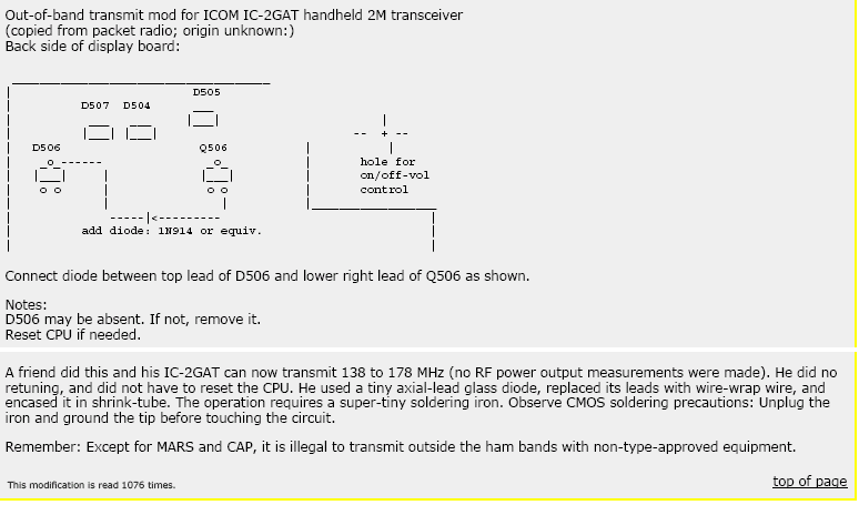

                             ICOM IC-2GAT
                               EXPD. RF
                              Drawing mod
 1- Remove battery and antenna
 2- Remove screws and open the radio
 3- Remove  D506 (this is already moved in U.S.A  version)
 4- Attach diod as shown (use 1N914 or equivalent diode).
    Make sure diode leads will not short anithing. Cover them in tape.
 5- Reassemble the radio.
 6- Reset the radio (Turn radio on. Hold [ LIGHT] & [ FUNCTION ]
    Turn radio off and back ON)
ไม่เก่ง แต่ไม่หยุดที่จะเรียนรู้

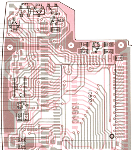

pichet♥
คะแนน176
กระทู้: 479
« ตอบ #6 เมื่อ: พฤษภาคม 02, 2007, 01:32:07 pm »
ดูตามรูปครับ Tongue

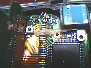

ช่างยุทธ YTN
คะแนน99
กระทู้: 1101
« ตอบ #8 เมื่อ: พฤษภาคม 02, 2007, 05:00:12 pm »
แกะเครื่องออกมารู้สึกว่าจะมีการเปิดแบนด์ใว้แล้ว
แต่เครื่องใช้งานได้เพียง 144 - 146 Mhz เท่านั้น
ลองกด Function + Light ปิดและเปิดเครื่องแล้ว
ก็ยังเหมือนเดิม เอาไงต่อดีครับ
(แต่รู้สึกว่าตำแหน่งการจั๊มไดโอดจะไม่เหมือนกัน)

HS8LBB
กระทู้: 64
« ตอบ #13 เมื่อ: พฤษภาคม 03, 2007, 10:49:54 pm »
จั้มไดโอดแบบรูปของท่าน pichet ครับ
