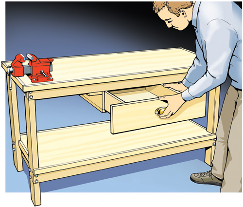

ของต่างประเทศครับ

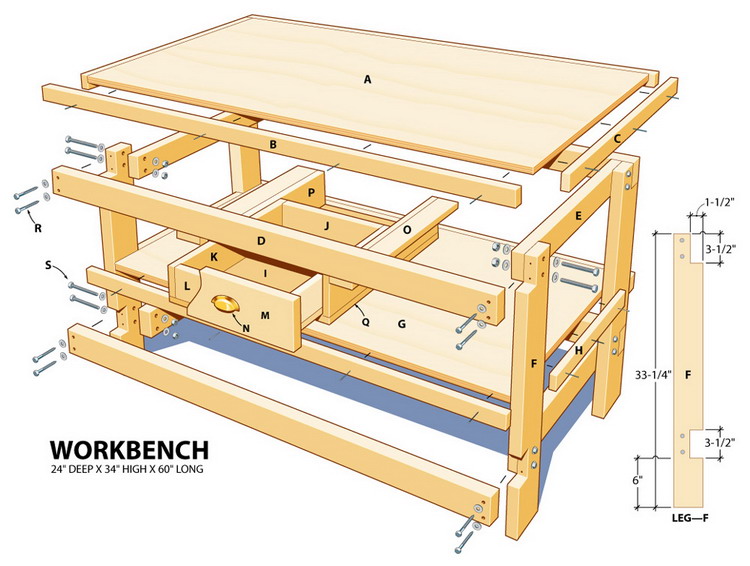

รายการไม้วัตถุดิบ สามารถดัดแปลงให้เข้ากับยุคและสถานการณ์ได้ครับ
A 1 3/4 x 22-1/2 x 58-1/2” plywood (top)
B 2 3/4 x 1-1/2 x 60” pine (edging)
C 2 3/4 x 1-1/2 x 22-1/2” pine (edging)
D 4 1-1/2 x 3-1/2 x 57-1/2” pine (long rail)
E 4 1-1/2 x 3-1/2 x 18-1/2” pine (side rail)
F 4 1-1/2 x 3-1/2 x 33-1/4” pine (leg)
G 1 3/4 x 21-1/2 x 54-1/2” plywood (shelf)
H 2 3/4 x 1-1/2 x 14-1/2” pine (edging)
I 1 3/4 x 18 x 21-1/2” plywood (drawer bottom)
J 1 3/4 x 4-1/4 x 16-1/2” plywood (drawer back)
K 2 3/4 x 4-1/4 x 21-1/2” plywood (drawer side)
L 1 3/4 x 4-1/4 x 16-1/2” plywood (drawer front)
M 1 3/4 x 7-1/2 x 25-5/8” pine (drawer face)
N 1  Drawer pull (see text)
O 2 3/4 x 3 x 21-1/2” plywood (support cleat)
P 2 3/4 x 5-1/8 x 21-1/2” plywood (support side)
Q 1 3/4 x 19-5/8 x 21-1/2” plywood (support bottom)
R 16 3/8 x 3” lagscrew, washer
S 16 3/8 x 3-1/2” machine bolt, nut, washer
