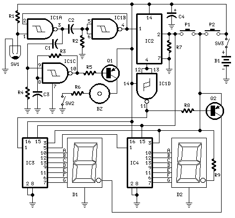

สุดยอดมากครับวงจร
* stepcount.gif (8.8 KB, 473x440 - ดู 771 ครั้ง.)
hnaning
กระทู้: 26
« ตอบ #4 เมื่อ: พฤศจิกายน 06, 2007, 12:54:50 pm »
R1,R3____22K 1/4W Resistor
R2________2M2 1/4W Resistor
R4________1M 1/4W Resistor
R5,R7,R8__4K7 1/4W Resistor
R6_______47R 1/4W Resistor
R9________1K 1/4W Resistor
C1_______47nF 63V Polyester Capacitor
C2______100nF 63V Polyester Capacitor
C3_______10nF 63V Polyester Capacitor
C4_______10µF 25V Electrolytic Capacitor
D1_______Common-cathode 7-segment LED mini-display (Hundreds meters)
D2_______Common-cathode 7-segment LED mini-display (Kilometers)
IC1______4093 Quad 2 input Schmitt NAND Gate IC
IC2______4024 7 stage ripple counter IC
IC3,IC4__4026 Decade counter with decoded 7-segment display outputs IC
Q1,Q2___BC327 45V 800mA PNP Transistors
P1_______SPST Pushbutton (Reset)
P2_______SPST Pushbutton (Display)
SW1______SPST Mercury Switch, called also Tilt Switch
SW2______SPST Slider Switch (Sound on-off)
SW3______SPST Slider Switch (Power on-off)
BZ_______Piezo sounder
B1_______3V Battery (2 AA 1.5V Cells in series) Sad Sad
