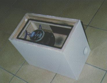

And this is what the finished product looked like, from below (with the bottom removed):
Inside view of El Uglito
The drivers were mounted from below, in the sealed section of the enclosure. The bottom of the sealed section was made removeable, so that the drivers could be accessed at any time. The bottom of the enclosure would be facing the floor when the system is in its normal position, so no screws are visible. Vf is 7.5 litres, and Vr about 10 litres. 3/4 marine ply, butt joints and aliphatic resin (wood glue) was used throughout. Drywall screws were used to hold the sections together while the aliphatic resin dried, then they were removed and the holes filled with wood filler. The enclosure was then sanded and painted with a white laquer (basically to stop the ply from splintering along the edges!). Tuning was done as outlined in the previous sections.
This is what it looks like from the front:
Front view of El Uglito

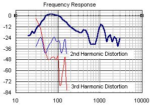

The final results are pretty good, if I do say so myself. The passband is very close to the predicted 52 Hz-126 Hz, and the noise band is pretty low in level - the highest point is 11dB below the passband, and the noise is virtually inaudible when the system is used along with two Mordaunt-Short 3.2's that I employed temporarily as satellites. A full frequency response check on the system shows that there's a very slight peak in the lower section of the passband ('round 60Hz or so) but that can easily be fixed by adding a bit of bracing to the front chamber to increase the tuning frequency. So far it isn't bothersome, so I haven't bothered to add the bracing.
Frequency Response - 22nd June 1997
Recently, I had the opportunity to measure the frequency response of the system again, using a technique I've been experimenting with over the past few weeks. The results are shown in graphical format below:
Frequency response
Notes:
   1. The peak at 1 kHz is the port resonance (a "feature" of almost all bandpass systems), and can be cured by a simple notch filter. So far I haven't found it bothersome (probably because I'm driving the system using an active filter in the amplifier).
   2. The small ripple at 450 Hz is caused by reflections from within the box, probably from the back panel, which is parallel to the port openings. The peak was reduced considerably by the addition of damping material in the front section - which in turn is probably causing the slight peak in output at 60 Hz, because the tuning of the front section has now been altered!. However, the slight bump at 60 Hz is a lot less objectionable than a huge peak at 450 Hz...
   3. The slight ripple at 27 Hz I believe was caused by a small leak in the sealed section of the system, which I subsequently fixed.
   4. The 2nd and 3rd harmonic distortion readings were taken at a drive level of 2.83 volts to each driver in the system, and the results were measured relative to the output level of the fundemental frequency at this drive level. At this level, the system was generating over 120 dB at the port in the middle of the passband. The rapid rise in 3rd harmonic distortion below 50 Hz is caused by the drivers exceeding their Xmax at this volume level.

น้องbmxไม่ทราบว่าทําไมถึงมาชอบตู้แบบนี้ครับ ตู้แบบนี้โดยมากเขาจะใช้ในรถยนต์เพื่อลดขนาดตู้ให้เล็กลง จึงนําดอก 2ตัวมาประกบกัน
ซึ่งใช้พื้นที่ที่จํากัดในรถยนต์เท่านั้น  โดยไม่ได้ทําให้มีความดังเพิ่มขึ้นแต่อย่างใดนอกจากเสียเงินค่าดอกเพิ่มขึ้นอีกตัว การทําตู้ isobaric
ไม่ได้มีผลให้เบสตํ่าลงได้อีก      น้องbmxถ้าน้องเอาแบบตู้นี้ไปทําอย่างเลยอย่างแรกเลยน้องต้องมีดอกสเปคใกล้เคียงกับเขาถ้าน้องเอาดอก
ถูกๆไปทําพี่ยังเดาไม่ออกเลยจะออกหัวหรือก้อย     จริงๆแล้วพี่เคยรีดสมรรถนะจากดอก 6 นิ้วอย่างเต็มเมื่อสมัยก่อนตอนเข้าวงการ ไฮไฟ
ใหม่ๆ ตอนนั้นตั้งประเด็นกับพรรคพวกว่า ต้องได้เบสลงได้ลึกเท่ากับค่า fs ของดอก นอกจากนั้นเบสที่ได้ต้องราบเรียบสมํ่าเสมอ จึงได้ทํา
ลําโพง Tranmission line ซึ่งออกแบบและจูนได้ยากทีเดียว   เป็นลําโพงตั้งพื้น 1 คู่ ให้เบสสะอาดและเกินตัวทีเดียว
เเต่ของพี่นั้นพลังที่ออกมามีดอก 6 นิ้ว 2ตัว แต่ของน้องใช้ตัวเดียวทําซับพี่ว่าเบสจะน้อยไปนะ ถ้าใช้ในรถยนต์หรือห้องเล็กๆก็พอได้
น้องbmx ไม่ใช่ว่าเราเห็นแบบเขาแล้วเอามาทําตามได้เลยนะคร้บทําแบบนื้เมื่อก่อนพี่ก็เคยทําแต่ผลออกมาคือเหนื่อยเปล่าฟลุ๊คยาก
คนฟังไม่เป็นมาเห็นบอกดังดีนะ ส่วนคนฟังเป็นเดินหนีฟังไม่ได้  ถ้าน้องคิดจะทําเองควรหาดอกที่มีสเปคมาคําณวณดีกว่า ไม่ต้องใช้โปรเเกรม
ก็คําณวนได้ เพียงมีเครื่องคิดเลขที่คิดเลขยกกําลังเป็นลบได้ก็พอ   ถ้าน้องอยากลองเผื่อฟลุ๊ควันหลังจะจําลองค่าโดยประมาณเอาเมื่อเสร็จแล้ว
จะส่งแบบมาให้เผื่อฟลุ๊ค
